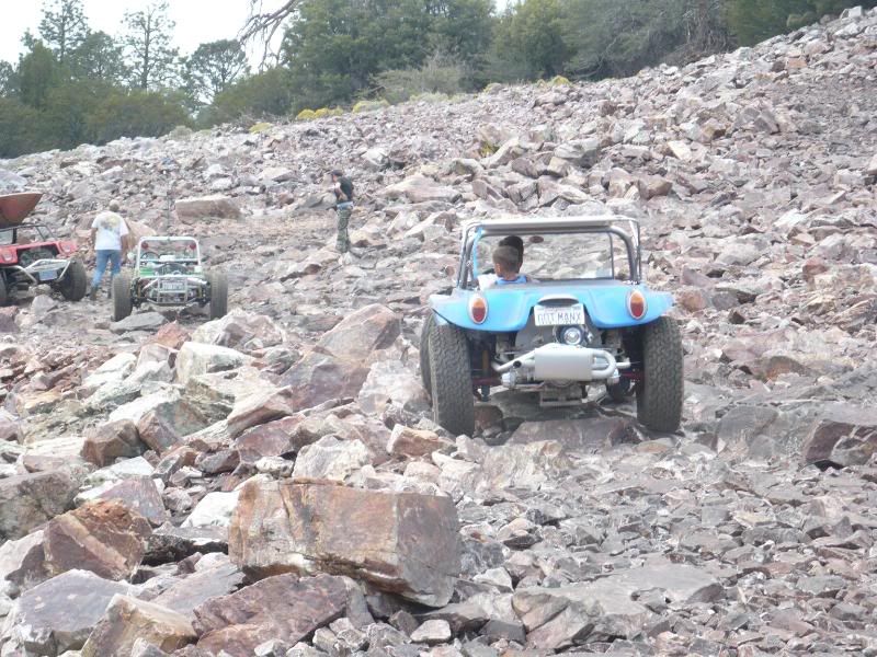

A 3" lift is reasonable for off-road (that is what we run). It makes the stance look more aggressive and gives room under the skirts for suspension modifications as well as beefier tires if that is the direction you want to go. I figure that a good off-road buggy will still drive well on the street, but a street buggy doesn't do well going over large ruts and boulders. So the choice for us was obvious. They still sell the cut-in/weld-in brackets (which work fine), and you would need a jig to get the alignment right. Ask around for a shop that has done the conversion before, or ask someone in your area that might have a set of jigs you could borrow for the install. If you are looking for a just a basic street buggy and are worried about cutting the glass, leave the SA, adjust it to a neutral camber, and you will still be able to drive on dirt roads or relatively smooth open fields. You will just have to be careful going slowly over any ruts or rocks in the road. You could also put on a camber compensator if you are worried about how the SA acts on the street when driving curves aggressively. Again, each buggy is a reflection of it's owner. The possibilities and combinations are endless!

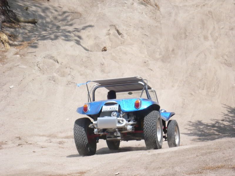

K.I.S.S. Keep it simple...well you know the rest. If it were me and I wanted to get the buggy up and running, I would keep the swing axle in it. I've got over twenty years running a swing axle in all kinds of terrain and it has held up great. For a mild off road, and even more, it wil be fine. The key is to get it going so you and your kids can enjoy it.
