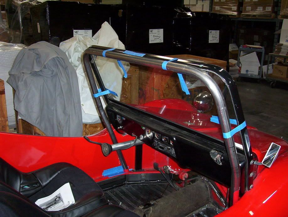

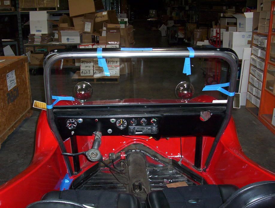

Here are a couple pictures that show a body lift from the inside of the car. The lift and roll bar are the handiwork of Rob (Speedee). Image Image
Reverb
Posts: 203
Joined: Fri Mar 18, 2005 10:00 pm
Post by Reverb »
Lee, what are those 2 black wide bars for that run up the side of the kick panels?

Reverb, The wide black bars are part of the original steering column mount. We will be changing the mount to make it part of the cage.
