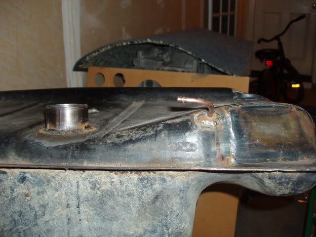

I ran into this problem when I was relocating my filler neck on my '71 tank. I ended up using the outlet pipe as a vent by drilling a small hole at the area of the original filler neck and welding it in place. It is in the top most location of the tank when installed in the buggy and is in an expansion area where there will be no gas. I'll attach a hose to it and loop it a couple of times. Being the same ID as the outlet I'm hoping for a neutral pressure when idle and running. Image

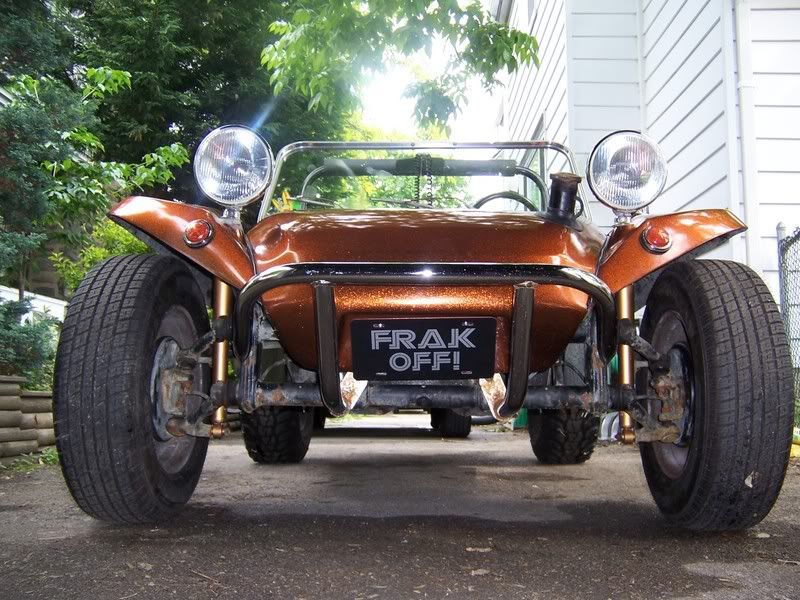

i don't have any problems with gas sloshing out. no loops in the vent line, it just runs down the side and behind the beam. i fill up to the top edge with gas as you're looking into the filler. Image
