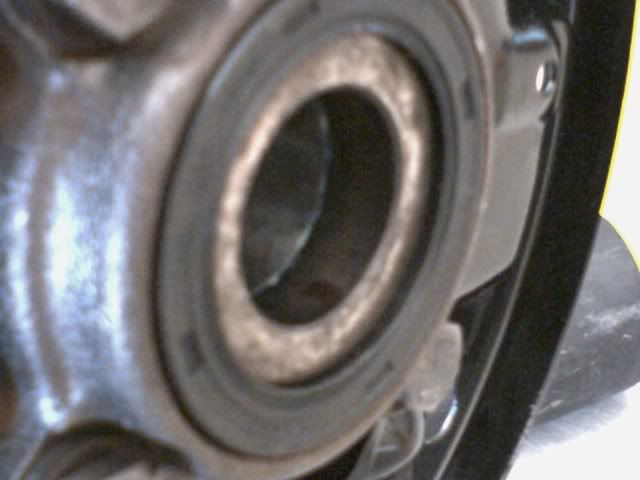

I was able to get some different seals from jsturtlebuggy that did the trick. Here is a pic of the correct seal.
As you can see it fits much different than the ones I got from the local shop. Pic below.
Be warned. Just because the parts guys say their parts will work doesn't actually mean they really will. Regardless, my axle seals are in and working as designed. Hooray! Moving on...
