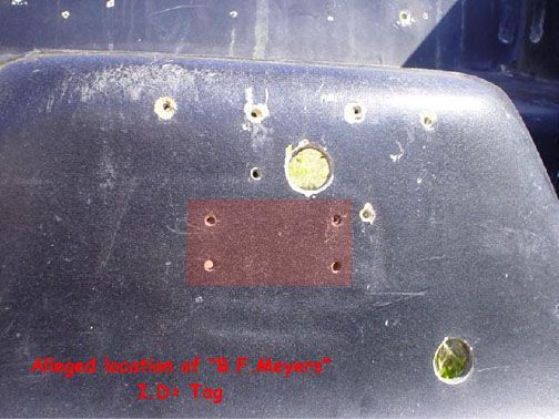

I'd also say original Meyers Manx: the body looks totally correct. It has the ABS plastic dashboard with metal frame and even has the original stainless steel panel that the rear license plate was mounted on, both are unique to the Meyers Manx. It also has a nice made in the USA pair of Deitz 820 headlights. Does it have a small metal tag attached with 4 pop rivets on the flat fiberglass area above the shifter coupling access panel, or 4 small holes where a tag used to be? If it doesn't, that doesn't mean its not a Manx. They didn't start the tag until 1968.

Many thanks to everyone for the comments and information. Tomorrow I will look at that plate near the pedals and I'll take a few more pics. The area behind the passenger seat does have a place molded into the body for a battery and behind the drivers seat is the same kind of thing only larger going deeper toward the rear. Also I see no signs of any tag or holes for a tag above the shifter coupling area. I did find an embossed number in the body flange area behind the driver seat where the floor pan meets the body. It looks kinda like "M1 CH xxxxx" but is very difficult to read. Don't know if that means anything?? Thanks again everyone for the help Sparky

Sparky, Here's the holes where the Manx ID was located on my 'project' body. Maybe check out the underneath side of the body, as maybe someone filled them in. And, you could have a pre-ID tag body, like cairomanx said. The previous owner (or maybe several of them), liked to drill on my 'project' body.
