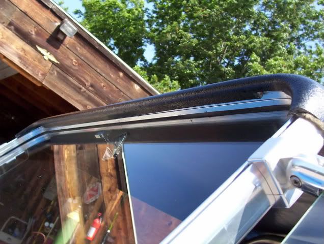

I have an original Manx hardtop that I am installing on my Manx. Is the front of the hardtop actually supposed to fit in the groove on the windshield frame? I can't see that happening in my buggy, at least with just one person installing it. It does fit over the entire windsheild frame nicely.

Jerry. I all so have a manx hard top it well fit in the grove on a old Manx window frame but not in the grove on my Sig frame when bruce had the sig frames bent they are not the same as the old. I think in one of the manx manias there is a how to fix. I well try to find it Nate.
My Manx hard top fits over the entire window frame on my Siggy Manx:
I also made brackets to keep the 'ears' of the top from slamming against the body on bumps. I used pieces of buffing wheel between the brackets and the body and between the ears of the top and the body:
The top is secured at the back with U-Bolts, which makes everything nice and solid. When using U-Bolts, you don't need to use the spring loaded system the top came with. The spring loaded system was designed to allow the top to move as the body flexed. Otherwise the windshield would crack. As long as you have the 1" tubing installed in the floor pan's outer channels the body won't flex too much. I just removed the hard top from my buggy and I don't intend to reinstall it. I have a list of reasons but the bottom line is I think I will be happier with just the roof rack or no top at all.
The top is secured at the back with U-Bolts, which makes everything nice and solid. When using U-Bolts, you don't need to use the spring loaded system the top came with. The spring loaded system was designed to allow the top to move as the body flexed. Otherwise the windshield would crack. As long as you have the 1" tubing installed in the floor pan's outer channels the body won't flex too much. I just removed the hard top from my buggy and I don't intend to reinstall it. I have a list of reasons but the bottom line is I think I will be happier with just the roof rack or no top at all.[QUOTE="markmark"]I prefer to drive my buggy without the roof. I only fit the roof if it's raining heavily. Just my preference........:2cents:[/QUOTE] I only plan on running the top when driving long distances on the interstate, the wind can take alot out of a person after 3-4 hours at 70-75 mph or on cold days in an effort to extend the season a bit.
