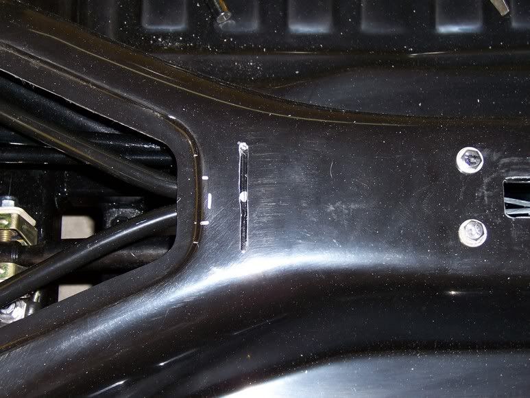

That looks FANTASTIC!!!!! I've got an earlier Berrien chassis, the front tubes are a little different, that I haven't touched yet but was wondering what you guys are doing to title these. Since there are no chassis numbers with the torsion housing, are you getting a state issued number, are you using the numbers off of the old bug chassis assuming you replaced an old chassis? I don't think its a big deal here in Colorado even if I have to get a state issued number, just wondering how everyone else is handling it. Jay

[QUOTE="Manxter26"]That looks FANTASTIC!!!!! I've got an earlier Berrien chassis, the front tubes are a little different, that I haven't touched yet but was wondering what you guys are doing to title these. Since there are no chassis numbers with the torsion housing, are you getting a state issued number, are you using the numbers off of the old bug chassis assuming you replaced an old chassis? I don't think its a big deal here in Colorado even if I have to get a state issued number, just wondering how everyone else is handling it. Jay[/QUOTE] Since the fiberglass floor that Berrien provides looks identical to the VW pan I cut an oval slot in the glass in the same location of the stock vin and glassed the vin in from the bottom. It looks like it came that way.

Jay, If you look at my pictures you will see a bracket behind the e-brake bracket where the original VW VIN is. My VW VIN will be put on there and there will be a nice slot cut in the fiberglass to view it. It also fits up tight against the floor pan. Thanks Tom, No comparison to your project, but this one will see the woods. The wheels were a $30.00 back yard find. Here is a picture after I started working on one of them. $30.00 for the wheels and $40.something for the center caps. :cry: Image

Jay, here is a picture of how where I am mounting the VIN. The small slot is just to make sure I am in the correct place before opening it up. When the pan comes off for the last time (I hope) I will open the hole. Image
