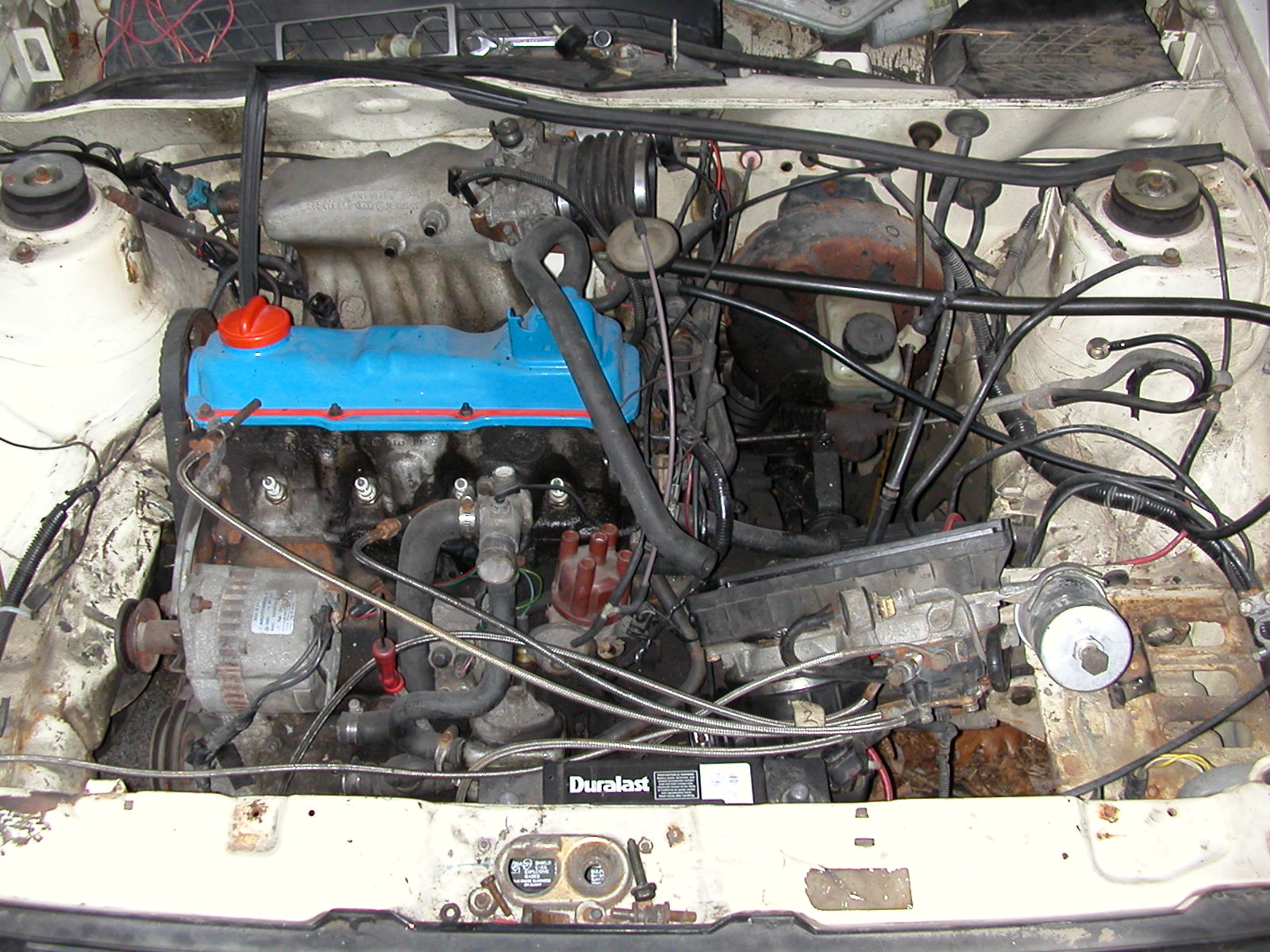

Here's the engine compartment from an '82 Rabbit. The reservoir looks exactly like the one I have (at least from above):

It's hard to be sure without seeing the nipples that go into the master cylinder, but if the cost isn't too bad, I would try an early eighties one.

Here's a lousy picture of the one on my buggy for comparison: Lee, Thanks for the pics of your Manx and of the Rabbits. I will take them over to the parts places and ask more questions. If and when I get an answer I will make sure and post it so any F/G Buggy owner that needs the info on their german master cylinder will be able to find the right one. Nice Rabits are those your new daily drivers? Thanks again See you Sat for breakfast! Bob
