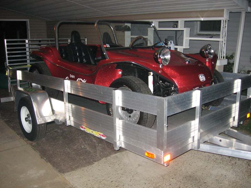

Now this is the only way to fly.
It is a Rance All Aluminum trailer 6x12 with gate ramp. I can drive right on and climb off. The sides are detachable and the next time I use I will probably leave them off. My buddy is a dealer and this was a demo he let me use last year. I am thinking about buying it, it was so nice. Biggest thing is the rubber torsion axle. No springs = No bouncing and jarring. Glides along. Weighs 500lbs and loads over 2400. Here is the exact specs..... OVERALL LENGTH W/TONGUE 15' 6" OVERALL WIDTH W/FENDERS 7'10" BED ONLY Width 72" Length 12' 1" Height 18" GVWR 2990lbs TRAILER WEIGHT 580lbs CAPACITY 2410lbs TIRE SIZE ST 205/75R14 TIRE RATING LRC WHEEL BOLT PATTERN 545 AXLE(S) 3000lb Rubber Torsion TONGUE 3" SQ. HITCH BALL SIZE 2" FLOOR CONSTRUCTION Aluminum Floor Plank STAKE POCKET Yes RAMP GATE Yes TILT BED No D-RINGS Yes, 4 Qty WHEEL CHOCKS No TONGUE JACK No STABILIZER JACKS No If you buy one for the little difference in price between an all steel leaf spring model I would go this way everytime. SERIOUSLY. John
It is a Rance All Aluminum trailer 6x12 with gate ramp. I can drive right on and climb off. The sides are detachable and the next time I use I will probably leave them off. My buddy is a dealer and this was a demo he let me use last year. I am thinking about buying it, it was so nice. Biggest thing is the rubber torsion axle. No springs = No bouncing and jarring. Glides along. Weighs 500lbs and loads over 2400. Here is the exact specs..... OVERALL LENGTH W/TONGUE 15' 6" OVERALL WIDTH W/FENDERS 7'10" BED ONLY Width 72" Length 12' 1" Height 18" GVWR 2990lbs TRAILER WEIGHT 580lbs CAPACITY 2410lbs TIRE SIZE ST 205/75R14 TIRE RATING LRC WHEEL BOLT PATTERN 545 AXLE(S) 3000lb Rubber Torsion TONGUE 3" SQ. HITCH BALL SIZE 2" FLOOR CONSTRUCTION Aluminum Floor Plank STAKE POCKET Yes RAMP GATE Yes TILT BED No D-RINGS Yes, 4 Qty WHEEL CHOCKS No TONGUE JACK No STABILIZER JACKS No If you buy one for the little difference in price between an all steel leaf spring model I would go this way everytime. SERIOUSLY. John-

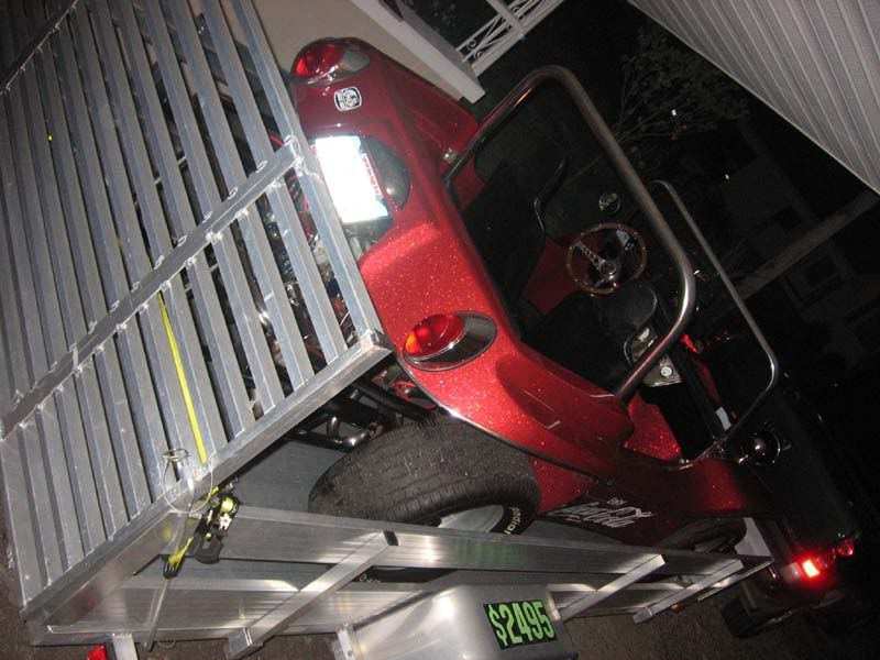

tail view......
The tail shot.... They list for $3,000 he sells them under list for $2,495. ...end shameless plug..... John
